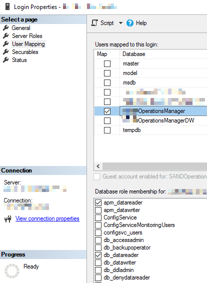

- Open SQL Server Management Studio.
- Expand Security and then Logins. Look for a login with the same name as the application pool identity, as noted above, if one doesn't exist you will need to create one.
- Right-click on the relevant account (as described above) and select Properties.
- Click on User Mapping.
- Tick the database you wish to give access to, for example
OperationsManager
, under Users mapped to this login. - In the bottom panel tick db_datareader.
- Click OK.
